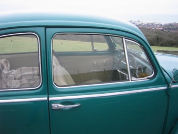

Hi there,
Don't know if you can see in th picture but my bug was bought from the original owner who bought it straight from the Wolfsburg factory in 1966. The handles shown are completely original. I have other "stock" photos of my bug too. I have since put on Flat 4 BRMs and lowered the front end as it had the original cross-ply tyre which were just a little scary!
