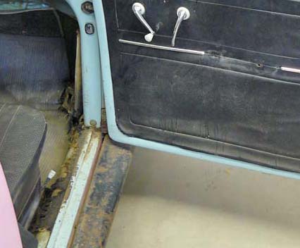

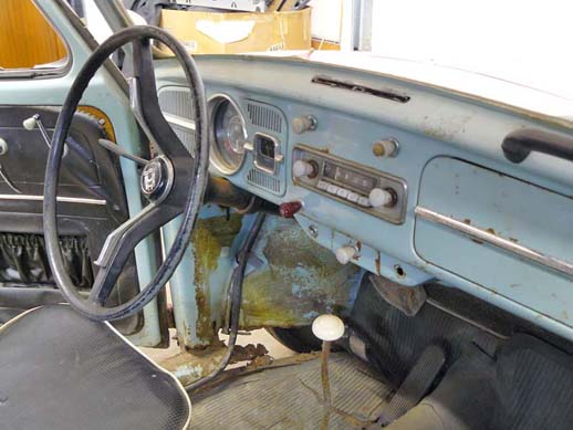

As you can see from these two pics, the front driver side is pretty bad. The front door post is actually detached at the bottom. The passenger side is much better, but I think I might as well replace both lower door posts.
passenger door inside sm.jpg (40.86 KiB) Viewed 11630 times
inside 1.jpg (57.96 KiB) Viewed 11630 times
If that bad
You may want to check the firewall under the tank as well. Mine overall was no where as bad as your pictures show but I had issues in the firewall. If you need the new bumper mounts for the front you should really consider getting the inner front apron assembly (if you can find it) as it has the mounts as part of it. I know they are pricy but if you can find it will save a lot of time and the welds hide easily in the fender well. I wish I had done that for mine as after replacing the bumber mount and the front left quarter I still have 6-10 hours body work to get it looking right. The backs don't come in a clip just the real wheel house with bumper mounts and the apron as a seperate piece. Again You should consider replacing it all since you are going to all the trouble and with new metal a lot less body work. The more metal in complete units you can get will save a lot of time. Don't forget to get a spot weld drill as that too saves a lot of time. You may need more than one as you are replacing alot of metal on the car. Another thing you may want to consider is creating an overlap seam if at all possible on the quarter panels with the new metal going behind the old rather than a butt joint. It is much stronger and a ton easier to weld as you can do spots and then seam seal rather than a log weld that warps the whole panel.

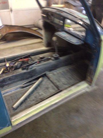

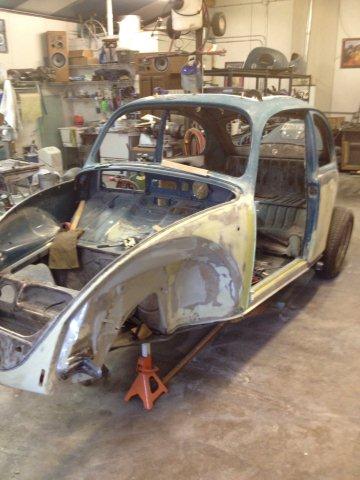

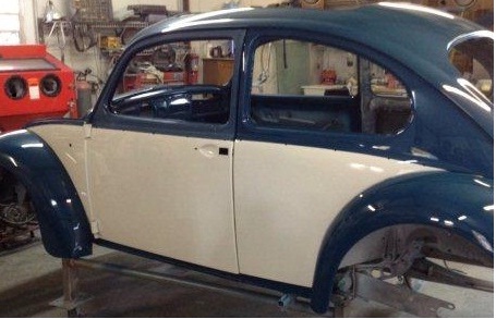

my work
As you can see, I replace the drivers front quarter, the door sills, lower 6 " of drivers A post, 6" of drivers rear quarter and part of B post, had to build the front bumper mount as quarter was for a 68 and later, pans, passengers A post lower 6", door sills and added a slider that was not offered for a 66. I alos had to narrow the front beam by 3/4 on both sides for rims to fit and lowered it 2.5 inches and have disks for the front. I hope to be done by spring. It has been sitting for a while now and I need to get back to it. Work has me travelling too much. Such is life.
pans
pans
front
front
