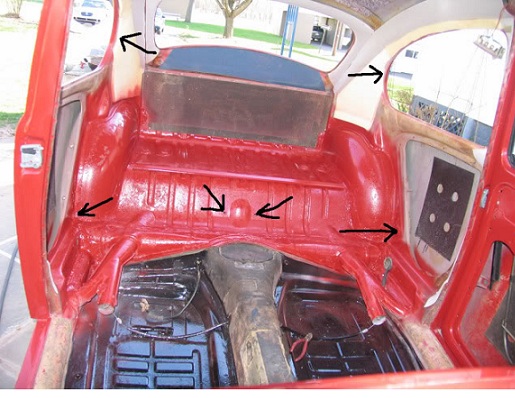

Ok I am new to beetles and fell into owning a 66 beetle (I think I like it)I already have a bay . What I need to know is can I fit seat belts into the rear are there bolt holes in the roof lining etc to mount them............

Yes, there are mounting points up above the rear window filled with a large Phillips screw plug..
My question is the lower mounts, There appear to be a set of center mounts high up under the seat back again filled with Phillips screws. As for the outside mount, there is a big bolt in the floor but it seems a bit too far inboard. What about the bolt that holds the seat-seatback? :?

Does anybody have a naked beetle shell that could take some pictures as I have no idea where in the roof to start please ..Thanks

Here ya go:
Holes
Holes

lilbugger wrote:Here ya go:
Wow that's my photo of my car! must have come off Samba - but it is there to be shared of course.

I am trying to locate the same holes. The arrows in that picture look to be pointing to where the seat back bolts to. Is that right? There seems to be a bolt the same size as a seat belt bolt that looks like it will work but it is on the floor. Please advise. Thanks.

Ben wrote:I am trying to locate the same holes. The arrows in that picture look to be pointing to where the seat back bolts to. Is that right? There seems to be a bolt the same size as a seat belt bolt that looks like it will work but it is on the floor. Please advise. Thanks.
Ben
The seat belt holes and seat back holes are close together. I'm sure I have a photo

Post by Ben »
Thanks, I am sure it is there. I need to go look again. Carpeting is in place, just need to peel back a little more.

my 66 only has the seat back holes where that arrow points and it doesnt have a seat belt mount hole near it at all. im trying to put seatbelts in mine and i dont know where them outside mounts are

i took some pics...
Is that a rusted, broken off bolt below the mount?

no, its some dirty foam or something not quite sure the exact material...

I'm doing the rear WW seatbelts now and found this picture helpful.
