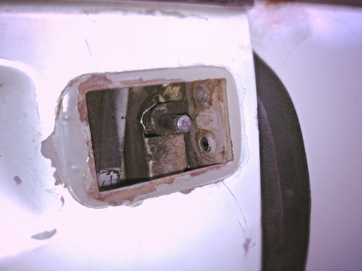

Drivers side, inside mechanics.
Photo (4) (640x480) (519x389).jpg (116.06 KiB) Viewed 5633 times

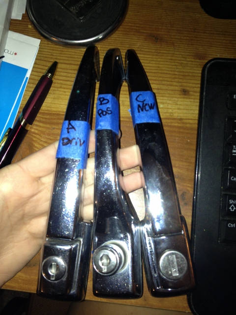

The tops of my handles.
photo (1) (480x640).jpg (204.14 KiB) Viewed 5633 times

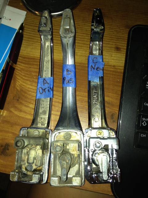

The under-sides of my handles.
photo (480x640).jpg (228.18 KiB) Viewed 5633 times

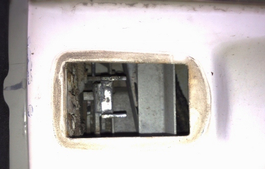

Last picture. Tell me what you think.
Passenger side, inside mechanics.
Photo (3) (640x409) (519x332).jpg (98.71 KiB) Viewed 5632 times

late 66 used the B handle and the last picture of inside the door. Early 66 used the A handle, throw C out or sell it.

You probably have a 67 door on one side. You will have to clean the locking mechanism. Everything in the door has to come out to get the locking mechanism out. It sucks, I've done it on my driver side

I looked at your handles again and A looks broke, but I'm not sure.

A '67 door will not fit a '66 because the striker mechanism was redesigned. Probably early '66 and late '66 doors, because the handle was changed mid year.
Probably had an accident, and a '66 door is a '66 door to anyone who needs one.
