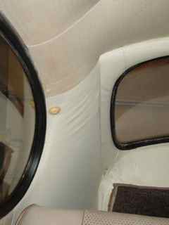

I have the same issue with my headliner. In fact I'm having a local repair shop in Cleveland Der Wagonwerks working on my headliner, focusing on the back area on both sides of the rear window. It was pretty nasty due to animals nesting there. The car sat in a barn for 6 years. Bill Webner, the owner, gave me a tip last time I talked to him. I'll ask him again and let you know.
His opinion was to keep the original headliner if it is in decent shape with now rips or tears, but it all depends on what you are doing with your car. I like everything to be as original as possible, even if it shows the natural wear over the years. These are 43 year old cars after all!

That would be great if he has some type of cleaning tip. I wonder if lightly fogging the headliner with a flat white spray paint would help hide some of the stains? I'm not looking for perfection here, I just want to clean it up a little, here's a pic...
You need to be careful. Some of the headliner may have the dots painted on. Check the back and front near the front and rear windows. I have two small sections with painted dots. I think that's how they did it. You can use the orange hand cleaner (without the gritty stuff) and gently try to clean the stains. GENTLY, gently. I've also used GOO GONE and it helps a little...and bonus the interior smells better for a while.
Bill is a genius. He had old material in his bins. It's lighter, but still matches the original style and color.
This is the spot repair done by Der Wagonwerks.
