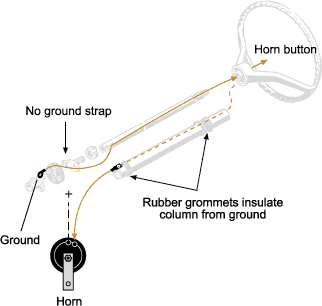

My suggestion:
First, check the horn fuse. The horn fuse is the first fuse on the left as you look at the fuse box from the driver's seat. This fuse also governs the lights and wipers. If they're working, that's probably not the problem, but you want to eliminate all the possibilities.
The horn has no polarity so either terminal will accept the positive or negative wire. Have a helper hold the horn button down while you check for voltage at the horn itself. First check the terminal that has the black wire with a yellow stripe, this is the positive (hot) wire. If your test light doesn't illuminate, trace this wire back to its source, the fuse box. Check both sides of the fuse with the test light. Current is supplied directly from the battery to this point so you should find voltage on both sides of the fuse.
Move back to the horn. While your helper holds the horn button down, attach your test light alligator clip to the black/yellow wire while pressing the ice pick end onto the brown wire. If your test light illuminates, this suggests that the horn is at fault. If it doesn't, the wire leading from the horn through the button to ground (the brown wire) is faulty.
If you don't have a test light, you can simply disconnect the brown wire, connect a wire to the second horn terminal and touch the other end of that wire to bare metal under the car while your helper holds the horn button down. If the horn sounds, the brown (ground) wire is loose or broken at some point. Aside from the horn itself being faulty, the most common source of horn-related headaches is a faulty ground wire.
Hope this helps...
horn circuit.gif (7.02 KiB) Viewed 38739 times

Where is the horn actually at? Mine won't work either. I'm new to Bugs and see from the diagram the wiring goes down the steering column, but I can't see where the horn itself is in case I need to replace it. Tks for any insight you have.
The horn should be under the drivers side front fender - take a look there you should find it - if not go to the other side and there check too!

How do you go about taking off the horn ring? I bought a new horn, and it won't work either. Not a fuse problem since the windshield wipers, etc works. B/4 I get into wiring, I'd like to check the contacts as you suggest. Is there an easy way to get the horn ring off?

Just wanted to follow up on an earlier post. Curious if someone can tell me how to get the horn part of the steering column off. I've got a horn that is not working and I want to see if it has to do with the contact points on the steering wheel. Thanks for any input!
f you're meaning the horn ring, I've always had pretty good luck with a screwdriver. Gently pop the center cap off, and then you can unscrew the ring. The screws are spring loaded, so don't lose any of the parts. :)

I wonder if anyone can help?
My horn is not working.
At the steering wheel (using a volt meter) i am getting 14v between the wire and the nut on the steering column. I assume therefore
1. All the electrics are Ok
2. As the colt meter completes the circuit and there is still no sound - the horn itself is dead
Is this correct???
