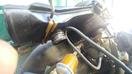

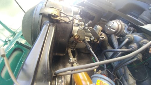

When it is cold and I start my beetle the choke control or whatever it is called flips over to where the round side is showing and the thing idles very fast.
There appears to be a place for a hose connection on the air filter and I am not certain where a hose would go.

Re: Throttle Control and Air Filter Connection
This Samba thread, although on a slightly different topic, will show the two locations used on the '66. First is straight down to through the tin to another connection piece (you need this to do it correctly, not hard to find at a swap meet) that brings air up from the 3-4 cylinder side. The other is like mine which curls around to slightly behind the fan shroud and goes through the tin to a heaterbox connection. If that connection, which you'll see in the b/w photo, is not there then you will have to use the hose-to-cylinder style set up.
https://www.thesamba.com/vw/forum/viewt ... ?p=7180500
The two different methods of preheat hookup is determined by what month the engine was made. An engineers prerogative or apparent whim if you will.
https://www.1966vwbeetle.com/images/1300%20Engine.JPG
The above link will take you to a picture of mines as well.
That's an excellent photo Jm. I have to give credit to this forum for the information about the two preheat locations possible on a '66 and why. So many puzzles, right? In my case, the 'Why' of my preheat hose location was the mystery. All other photos showed it to be as is in your photo, which made me suspicious as to what motor was really in the car; although the ID number began with the correct -"F" letter. Anyway, a properly worded Google search included this site as having information and it was one of those small gold strikes one can get.
Also, I'm envious of your correct year air cleaner. Mine remains what came with the car; a 40hp style. Not the only item on the car that comes from an earlier year. One more thing to be corrected down the line. There is a list.
