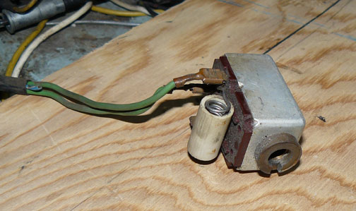

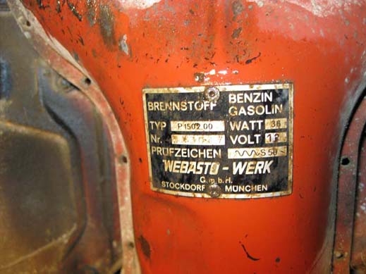

PHOTO 1 is a component behind the dash that was just laying there ...not mounted to anything. The wires, two green, and one blue with a white tracer (you can see where the blue wire has been cut as it goes into the harness) are not connected to the fuse panel ...they go directly into the wiring harness heading to the rear of the car. There is no part number on this component. The inside of the brass part appears to be threaded, and there appears to be something missing from the inside: a shaft and knob, perhaps? There is a hole in the dash to the right of the ashtray, where this appears it might fit ....but I don't know. PHOTO 2 is a box mounted to the firewall in the upper left hand corner of the engine compartment. My best read of the part number is "Prufhex" 117 963 457 006 6 Volt Made in West Germany There is one fuse in the box, with a screw-off cap; another in-line fuse attached to the box. The large, thick black wire seems like a high-tension coil wire, but not sure where it goes once it enters behind the engine tin. This is a bone stock 66 Deluxe beetle sedan, still with the 1300 engine, and 6 volt electrics. Any suggestions / comments appreciated
Mystery box Photo #2
mystery box.jpg (48.74 KiB) Viewed 7155 times
Photo #1
Photo #1
vw part.jpg (61.25 KiB) Viewed 7155 times
Those are the remains of a gas heater (dealer installed - hence no mention in any factory wiring diagram) once in car. The switch on the dash turned it on and the box in the engine compartment was part of the ignightor system. There were a couple of models with one under the hood in the truck with a vent just under the ash tray (you can see on YouTube) and one in the back that ran to the ducts from the back of the car. You may find the remains of the heater carcus underneath around the transaxle. Have fun!

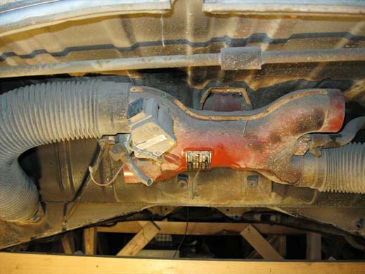

Yes, the part number would seem to indicate 1967 ...and thus 12 volt. However, my car is definitely still 6 volt. Would the rear mounted heater be one of those flat, x-shaped jobs? I sent an email off the Prufrex (they still exist) and asked them for info on the part #. Be interesting to see if I get a response. None of the info I've found on this site deals with the rear-mounted gas heater ..so don't know where else I might find info. From what I can see, the gas heater unit is still there, tucked up under the transmission, with the flex hoses running from it to the heater channel ducts, and a small one-inch or so exhaust pipe on the passenger side in the engine bay, behind the rear wheel. Can't wait to get this car up on a hoist to have a better look at what's going on underneath.
take pictures as I have found none of this unit
Pretty hard to get any kind of decent photo because it is tucked way up in there. Will see what I can do ...short of removing the engine (right now, anyway).

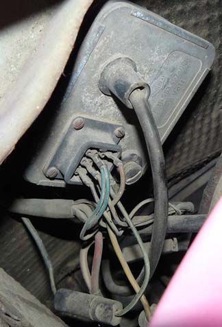

Here's a couple of pics of a rear-mount gas heater. Found them on a thread on TheSamba. It's a 12 volt model ...couldn't find other details.
webasto 2a.jpg (53.32 KiB) Viewed 7119 times
webasto 1a.jpg (49.74 KiB) Viewed 7119 times
