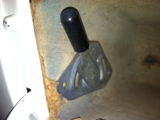

5. There is a lever inside the glove box that isn't attached to anything. (see pic below) Any idea what this is for?

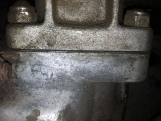

Thanks for the info on the turn signal. Any ideas on identifying this engine? Also, the lever in the glove box used to be connected to some kind of cable.

- Lever inside glove box

- No engine number

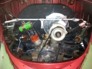

Pic of the engine
Here is a pic of the engine
- Engine
- image.jpg (32.3 KiB) Viewed 14975 times

That lever, I recognize that from my 74 superbeetle's glove box, that was the hood release for that model.
On my 66, the hood release is a black knob on the driver's side under the dash. Do you have this one?
As far as the engine goes, my conjecture is that is NOT the original engine, but a new one built by some aftermarket people, hence no VW markings or numbers where they usually would be.
That doesn't mean the numbers wouldn't be there, you just aren't looking in the right place

Digger89L wrote:That almost looks like the engine number was actually ground off .....unless, as the previous poster said, it's from a different year/model and the number is stamped elsewhere. I'd leave the orphan lever in the glovebox ....anybody asks, tell them its for the ejector seat!

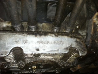

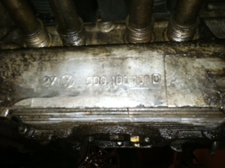

How about thes engine numbers from underneath?
So what about these numbers from underneath? can I identify the engine with them instead?
If not, whwere else can I look for engine ID numbers?
Thanks
Thanks
- drivers side
- engine #2.JPG (37.01 KiB) Viewed 14944 times
- Passenger side
- engine number 1.JPG (41.99 KiB) Viewed 14944 times

The only place for the engine number is on the block right below where the generator pedestal bolts up. The numbers you show in the pics are VW part numbers.
My guess is maybe your original glove box was lost or damaged and replaced with a glove box from a newer beetle that had the trunk release inside the glovebox.

1. I wanted to ID the engine but i'm having some trouble. There are no stamped numbers where they should be. (See pic below) how else can I identify this engine?
You can't ID the engine. It's a replacement case.
Glovebox has been replaced with one from a later model -- the handle goes to nothing.

I believed it would be more likely that it would be a replacement engine block than the numbers would have been filed off.Blue Baron wrote:Sorry if some of my answers are redundant to what has already been posted.
It's not that filing off of numbers doesn't happen in the automotive world, when it does, it usually involves theft of some sort.
Not sure if you have converted your bug over to 12 volt or not, but I know in the hot rod scene, they invented "keyless entry" with solenoids hooked up to the door locks. J.C. Whitney used to sell universal kits for that kind of thing. Not sure how big of a PITA it would be to get that installed, though.2. The back of the bug has definitly been lowered, and one of the shocks is missing. I want to raise it up just a bit to be more level with the front. I should probably replace the existing shock as well, right? If so, is it OK to use stock shocks if it is lowered, or do I need to get a shorter shock for it to ride correctly?
