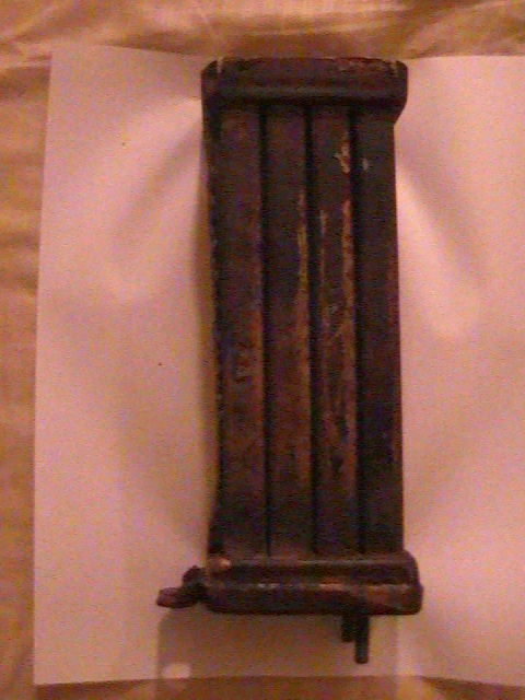

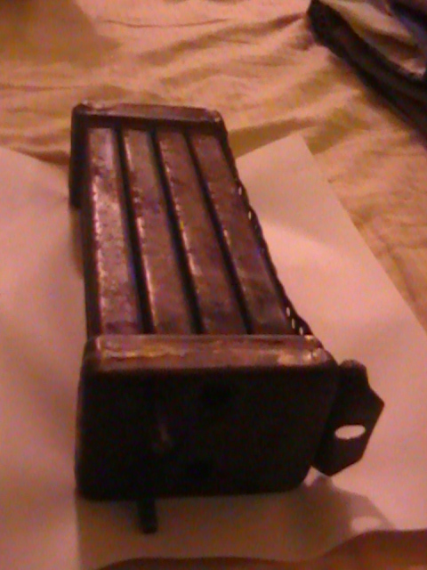

And here are the pictures I just took of the cooler itself.
If you need more pictures or info, please let me know.
Thanks!

Yikes. That debris is bad. So bad that I would consider replacing the cooler. New genuine VW coolers are available for around $50.
The seals are available from most VW parts suppliers for a couple bucks and are also included in the engine rebuild gasket set.
And yes, this is the 1970 or earlier cooler, not the doghouse style.

Well, I've definitely considered it more than once. If I do replace it, is there a way that I can make sure I'm getting the right seals to match the new cooler to my case and be done with it?
Yes, match them to your old seals. You need the barrel type, not the donut type.
