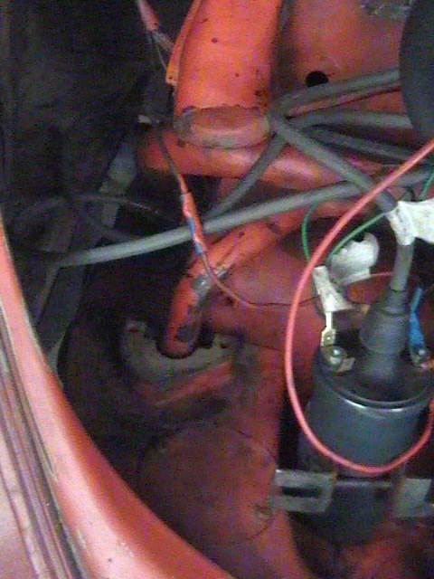

In your photo, the brass cylinder is the idle cutoff solenoid for the carburetor. The other red lead there should go to the choke on the carb.
When you say it won't start, can you elaborate on what it's doing? Is it turning over and just not starting? Is it not even turning over? Will it start but then die immediately?
