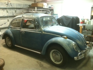

Thanks for the offer BB. I was going to bring it to Total Performance in Tampa to get front end suspension work done and was just going to let him fix the clutch problem as well. I am in Trinity around Hwy 54 and Little Rd area. I had got the engine running great and then the clutch problem came up so I have not been driving it. I just want it fixed yesterday, I LOVE driving it. I am new to Bugs, just bought this 66 a couple of months ago from a guy in Plant City. I think the bug lived in Sarasota, Fl, as evidence from the old oil change sticker on it from the 80's, that would explain the rusty pans that will need replacing as well some day in the not to distant future. Thanks again for the input, I will be in touch.
bug 1.JPG (32.71 KiB) Viewed 4321 times
Always surprising to see what turns up locally. I hadn't seen this car before.
