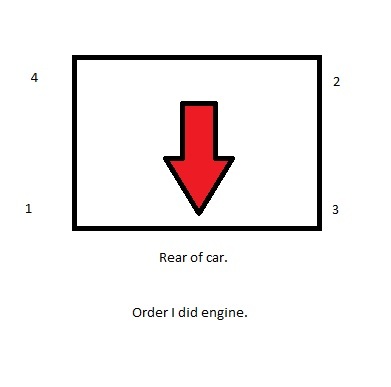

Hi Fatal,
This is what I did not sure if have done somthing wrong here but this is the path I took,
No.1 - 2 -3 -4. and to make sure I was adjusting correct valves to which cylinder I watched which direction the Rotor arm was pointing to following its spark lead through to cylinder and working on that cylinders valves, once I was happy with the adjustment I rotated the pully around. to next cylinder.
I used the (0.15 mm) feeler gauge for gaps.
On the plus side... the horrible leak that was coming from my main engine seal has completely stopped! so something worked well!
I also noticed tonight when I got home the engine was quite HOT using the poor mans tech holding the dip stick almost burning my fingers, which never happens the engines dip stick is always safe to hold, it also seemed to backfire when cold now, so I have definately botched somthing up!
From Fatals coment I believe that I have incorrectly adjusted these as you said wrong order... Im scratching my head but the only thing I can think of that I have done wrong was possibly turn the pully clock wise instead of counter clockwise.... which would make sence.
If this is the case, how do I go about fixing this horrible mess I have created for myself!? was I at least on the right track in what I was doing?
If I continue to drive with this what am I likely to do to the engine? As I live 60 minutes away from where I do all the work on my vehicle! which is a bit of a hassle but I love driving it!

.015? Yoikes! Waaaaaaay too loose. .006 intakes and exhausts. That's part of why they're so chatty, and definitely part of your power loss as well.
Also, your diagram has cylinder positions swapped. 1 and 2 are passenger side of the car, 3 and 4 driver side. If you have factory cylinder head tins, they're also marked on the tin outskirts to help you remember.
