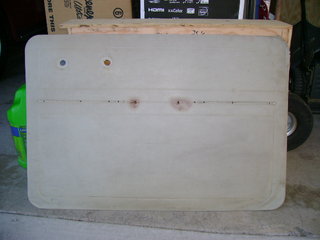

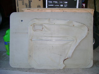

These are the ones off my May '66 Beetle sold new in USA. You can see they are pretty rough, and these are the good ones!
The pictures are poor and I can try and take some better ones if asked. They feature two plain rectangular panels formed by embossed seams that look like cording, one above and one below the trim. The trim is perfectly horizontal, front and rear. The trim on the driver's door is one piece w/o armrest, and is in two pieces on the passenger door. The armrest on the passenger door is also horizontal, and is in line with the trim.

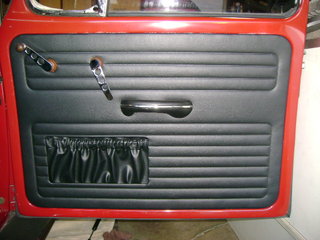

This is what TMI sells as '65-'66 door panels at 124.95. Notice that they are more heavily padded, have panel shapes that are no where near original looking, and the pre-marked holes for the armrests are at the wrong angle. Also, there is no practical way to install trim on the rear panels, as the feature lines curve downwards
They may make a better panel at TMI, but their catalog and ordering process had me running in circles with SoCal Imports where I ordered them from. Took three months and was happy just to get anything from them at that point.
I know they don't match the original, but I'm going for a nostalgic theme using the wood handles and changing to black. As a kid from the '60s, it reminds me of simpler times.

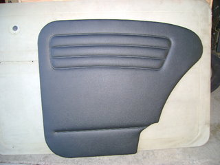

I received the panels from West Coast Classic Restorations, and here's the lowdown:
First the panels themselves: Gorgeous! Fantastic! I'm totally happy with them. They're not dead identical, but they're so close that nobody would notice or care, plus all the holes were there in the right spots for the chrome strips and arm rest. The heat pleats were a perfect '66 pattern. They have slightly more foam under the vinyl than the originals, but this makes them even nicer than stock. I ordered a rear ashtray delete and it looks great. And the price wasn't as crazy as I expected.
Now the bad news, the packaging was terrrible. One rear panel left an impression in a front one because the foam between them shifted, and one corner was torn up from exposure during shipping. It looks okay now after a vinyl repair.
But probably the worst part is dealing with Lenny Copp. He doesn't return phone calls or e-mails, and even hangs up on you if he's talking to another customer. It took weeks of phone calls just to get these things under way. And even after I told him upteen times they were for a '66, he made '67 panels before finally getting them right.
To sum up, I'd give the panels themselves an A grade, but the customer service gets a D minus, and that's being charitable. Is it worth the hassle? Definitely, but good luck trying to herd Lenny.
