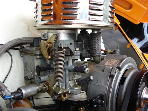

Here are some photos.
front (2).JPG (82.22 KiB) Viewed 15303 times

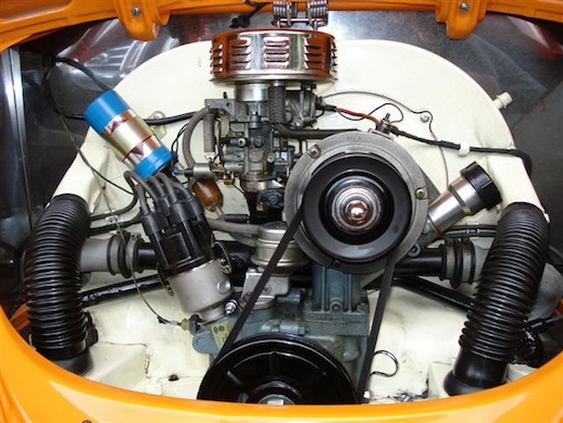

Another pic.
full front (2).JPG (88.38 KiB) Viewed 15302 times

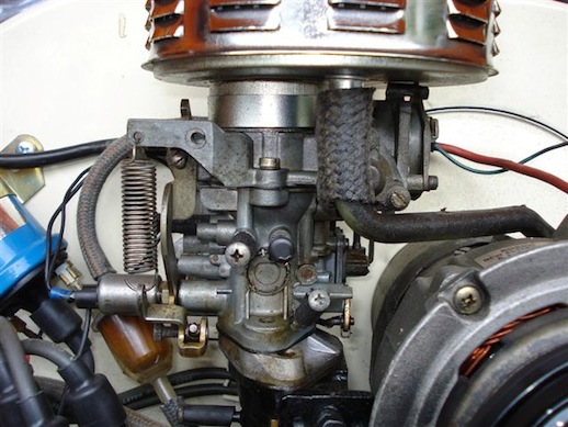

One more.
left (2).JPG (81.58 KiB) Viewed 15300 times

Hi. I cant help with the specific problem, but after having a look at the photos, if it were me I would certainly be doing something to secure the fuel hose onto that fuel filter you have fitted. If you dont use some clips it's only a matter of time before the hose comes loose and you have fuel all over a hot motor. Cheers.
As long as the fuel line is replaced annually, clamps aren't necessary. I would suggest instead moving the fuel filter under the rear of the car between the engine and the chassis. It's a little tougher to access there, but it eliminates a fire risk.
Okay, you have a replacement 30/31 on a dual-port engine with a manifold adapter for the smaller carb base. A 34 Pict will improve performance slightly, but I'd still advise switching to a larger main jet in your current carb. The main jet is in the bottom of the float bowl and you need to go to a 127.5 or 130.

Hi. I agree with the recommended new location. Have mine as recommended by BB. But having seen a local VW go up in smoke better to secure the fuel line with clips and reduce the risk in my view. Cheers

Can any tell by looking at my photos if my engine is a single or dual port?
Thanks!
Dual port. The manifold end castings "part" into 2 intake runners at the head. A single port would look like one continuous pipe, or in some aftermarket setups, the end castings would still be separate but would look like a larger pipe slipped over the smaller center pipe section.

Honestly, unless you lean it out to the point that it barely runs, your VW is not going to pass a modern emissions test. And that goes double for the 009 distributor. It might be helpful to switch to the old-style vacuum advance distributor. Also, that little constrictive breather tube isn't helping things either (not to mention the Taiwanese air cleaner ...)
