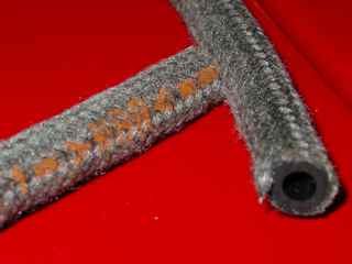

I was able to get the cloth covered fuel line from Wolfsburg West, but you can get it on-line from a lot of places. I don't know where you live but I was able to find a local foreign auto parts store that carries a bunch of air cooled auto parts and they had both the proper cloth covered fuel line (gray) and the brake line for dual systems (blue).
The fuel line is gray with orange lettering that says Made in Germany and a part number. Here is a pic.
Stock Fuel Line
Stock Fuel Line
