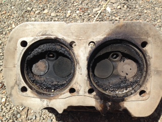

Hi.
I wonder, for parts that have done about 5000Kms car mileage, what might have been the issue to warrant such damage? (Is it an issue of carb tune-up? Running rich or lean???which one?)
Sorry- image too large- thing is, it almost looks like an arc welding job was going on in there (in the combustion chamber)

There's the image.
That's terrible for such low mileage.
It could be running rich, or you could be having detonation problems. This can be caused by too high compression for the lousy grade of gas you're using. Did the engine ping or diesel?
A solution could be lowering the compression ratio by shimming the heads. (Or find a higher octane gas.)

Hi Blue Baron.
What about running lean? I have observed something in the recent past- my fuel pump doesn't pump efficiently- apparently the fuel pump shaft is shorter than (compared to another- I actually didn't know they came in different lengths) what should be on the engine so I end up getting insufficient fuel supply which in turn gives me hesitation on high raves. I suspect I end up running lean.
The other factors you stated may be so. I didn't understand the sentence "...did the engine ping or diesel?" I use petrol.
I have since put the engine aside as until I can fix those heads. I, fortunately have another similar engine that's in use.
I may wish to say, of all other engines used, I've never seen such (including the "spare engine"in use...and all factors seem constant. I suspect it might have been poor timing or as I mentioned above...well. I'm still in more "grey" than light about it.
