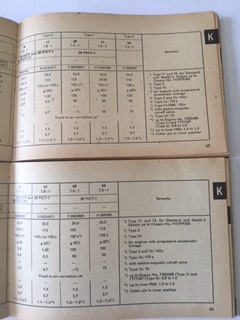

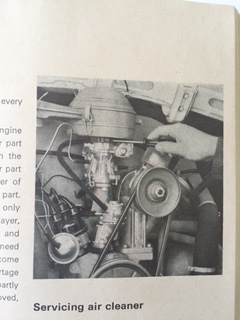

You are not confusing the wiring diagram. The same applies from 66 on. The reason it was in the 66 bug is there were multiple models for multiple countries (not the US) some which included the solenoid. The solenoid was used from 1963 on in various VW Models (bug, bus, ghia) and engine types. VW Choose to make the change to the harness in 1966. In previous models they ran the switch from the hot leg on the coil with a jumper for the choke and solenoid.
The PICT1 was a multi-year use carb and is different (US models) from 66 to 67. This article explains the difference very well:
http://1967beetle.com/30-pict-1-carburetors/
I have come to the harness conclusion because there were changes added in 66 that were prepping for 67 and looking through documentation there in no mention of the solenoid being used in 66.
I have attached pages from the "Without Guesswork" (both 66 issues) pocket shop guide and in the type 1 section it references the PICT 30 and it does not mention the solenoid being used in 1966.
I also attached a picture from the 66 VW 1300 Type 1 (US) owners manual and it is not on the carb. I could find no pictures showing the unused wires in the harness.
I can send clearer pictures if needed. Hope this helps answer your questions.

Awesome Info
Thanks for your complete and thorough answer. Much more than I could have hoped for.
Also, I have verified that the solenoid on my bug is being powered by a lead from the coil. So it all seems to make sense now.
And although I love how original my bug is, I'm going to leave the solenoid in place.
Thanks again.
Thanks again.
