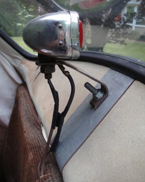

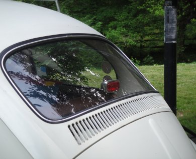

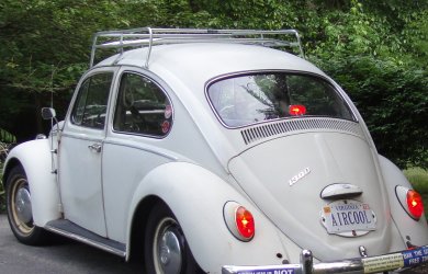

I did this and I am happy with the brightness. I started with a Hella bumper mounted reverse light. I replaced the clear lens with a reproduction 1957 and older type II brake light lens. They are available in glass or plastic. Mine is glass. I haven't owned a plastic lens so I can't comment on them. The metal for mounting it is custom/modified. I tapped into the original brake light wire where it ran underneath the rear seat. I also ran a ground wire from the light housing to a bolt underneath the rear seat. You can fit either a 6 or 12 volt bulb in the housing. Mine is 6 volt. Pics are viewable in the photo gallery.

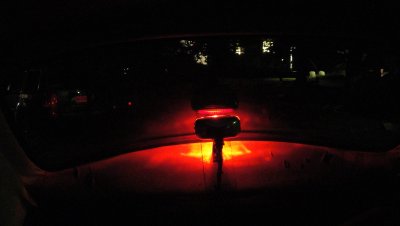

With that light being off the rear glass, and not sealed around the edges, does it not light up the entire back glass red, at night?

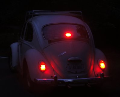

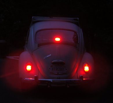

I went out tonight to check it out. It does light up the immediate glass area a bit but I don't think it is all that distracting. It actually lights up the area under the rear window more. Here is a picture of it taken at night. It's very dark behind my car so I think the glare appears more distracting in the photo than it actually is.

h~moto wrote:I went out tonight to check it out. It does light up the immediate glass area a bit but I don't think it is all that distracting. It actually lights up the area under the rear window more. Here is a picture of it taken at night. It's very dark behind my car so I think the glare appears more distracting in the photo than it actually is.
Any way to get a picture of what the other person sees at night? In other words, how visible is this to the guy behind you? You're always better assuming people around you don't know how to drive correctly.
