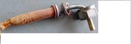

You may want to pull the filter screen off the bottom of the tank to make sure there is no debris. You may have cleared a hole for now but if there was a lot of debris in the tank it may settle and cause problems later. You may find the screen gone as over time they rot out depending on what is in the tank. Just a thought.

didn't see a screen of any kind on the bottom of the tank. Just the fitting that the fuel line hooked to.
It should look like the photo....If the filter is gone, you can buy the whole assembly for around $15. I would suggest you add if missing as well as have the inline filter between the hard fuel line and carb in the engine bay.
Tank Filter
Tank Filter

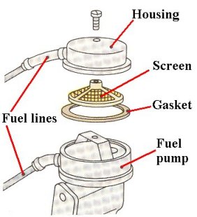

BTW, orginally there was no inline filter between the hard line and the carb as many run now. The filter was a combination of the tank filter and the pump filter. The pictures show pumps both old and new. The old pump had the filter screen behind the brass nut on the pump. The newer sytle had the filter screen under the pump dome. You may want to check these filter screens if you have not done so.
If there is no filter, you may want to add one of the ordinary plastic types. I always install it in the fuel line just ahead of the engine over the transmission. If the car hasn't run in a very long time, you'll also want to replace all the gas hose front and rear with German braided gas line.
