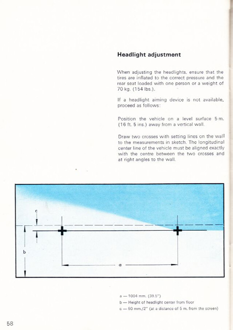

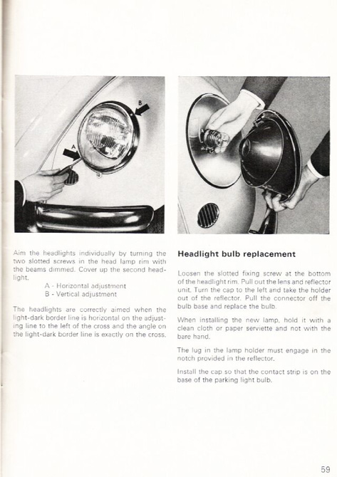

See attached pages from the 1966 Australian owner's manual. Pretty straight forward really.
second page
second page
first page
first page
That's a bad chart for left hand drive vehicles because it will result in your headlights blinding the oncoming drivers. (Assuming your car is 12 volt!)

Good point: forgot that the Australian model would be a right hand drive, and that that would make a difference on the headlight settings. However, it wouldn't take a rocket scientist to convert the right-drive setting instructions to left-drive settings. Mirror image of the chart I posted.
