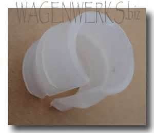

Does anyone have any alternative to the standard shift rod bushing. The groove that sits in the ring appears to be very thin and easily worn.
I was wondering if anyone has used the shifter mount box for the sandrail in type 1 beetle as a fix.
Refer to attachments.
Obviously the shifter box would require altering the tunnel and some welding but the durability would be worth it.
Thanks in advance!
sandrail shifter box with durable urethane bushing
th (2).jpg (5.97 KiB) Viewed 13077 times
traditional bushing
traditional bushing
