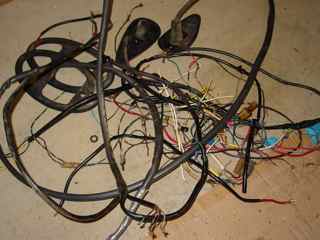

Recently I replaced the entire wiring harness and I'm really glad I did. The car is safer (previous owners or their mechanics did some serious hacking and splicing with incorrect gauge wiring to the front light looms), the charging system warning light doesn't have that annoying red glow and the lights are brighter. Maybe not 12v bright, but brighter. It cost me under $150 for a quality harness and a long weekend of careful wire pulling and connecting. It's also a great way to know your car's electrical system better.
Out with the old...
Out with the old...
